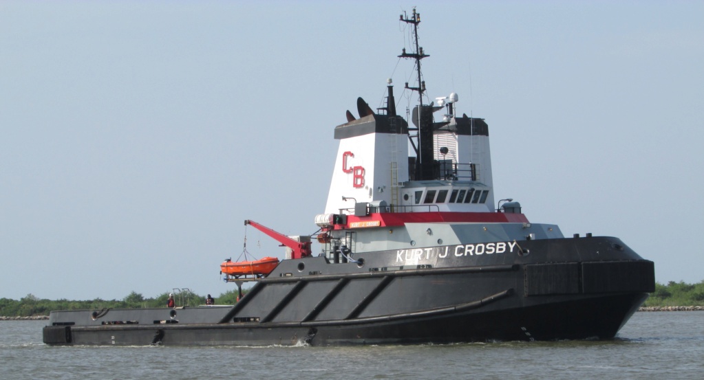

Tug set out and tested anchors for crane barge
Oct 05 10:54The tug 'Kurt J. Crosby' set out and tested anchors in preparation for the arrival of the 'VB 10,000' crane barge tasked with cutting and lifting the pieces of the 'Golden Ray'. The five anchors placed in and around the environmental protection barrier by the tug will help stabilize the VB 10,000 when it begins cutting into the ship's hull with powerful winches and 400-foot-long anchor chains. Each piece will then be loaded onto an awaiting barge and hauled away. Each anchor has to be pull-tested to ensure it will withstand the strain of the cutting and lifting. Roads into Epworth have been blocked, and security guards were patrolling 24 hours a day to keep everyone out and everyone in. Even pollution control crews and others on the perimeter of the mission were prevented from having contact with the sequestered workers. Their ranks included welders, salvage masters, electricians, mechanics, deck hands, naval engineers and all 50 of the folks who crew the 'VB 10,000'.

Kurt J. Crosby - IMO 9231341
![Global Actualité maritime 2020 - Page 19 21038611](https://i.servimg.com/u/f69/17/64/70/68/21038611.jpg)
![Global Actualité maritime 2020 - Page 19 21038610](https://i.servimg.com/u/f69/17/64/70/68/21038610.jpg)
Vessel Name: KURT J. CROSBY
USCG Doc. No.: 1096764
Vessel Service: TOWING VESSEL
IMO Number: 9231341
Trade Indicator: Coastwise Unrestricted, Registry
Call Sign: WCZ8883
Hull Material: STEEL
Hull Number: 6930
Ship Builder: BENDER SHIPBILDG & REPAIR
Year Built: 2000
Length: 133.8
Hull Depth: 21
Hull Breadth: 48
Gross Tonnage: 296
Net Tonnage: 201
Hailing Port: NEW ORLEANS, LA.
Previous Vessel Names:SIDNEY CANDIES, M/V SIDNEY CANDIES, M/V SIDNEY CANDIES
Previous Vessel Owners:OTTO CANDIES LLC, CROSBY MARINE TRANSPORTATION LLC
