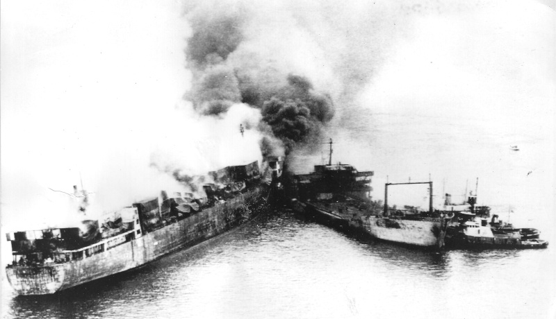

Une vue de la collision entre le pétrolier belge ESSO BRUSSELS et le navire américain C.V. SEA WITCH à New York le 2.6.1973

1.10.1963 collision o/v Antwerp-Mena al Ahmadi, 2 days after passing Gibraltar.
3.1.1964 arrived at Antwerp in tow, after collision on 31.12.1963; repairs till 16.1.1964
28.11.1968 arrived at Antwerp for repairs till 6.12
2.6.1973 at 00.42 collision with American C.V. SEA WITCH (17902/68, American Export
Isbrandtsen Lines Inc) while at anchor off Stapleton, New York harbour, o/v Bonny
(Nigeria)-New York (Bayway refinery). Both vessels quickly became engulfed in fire and thick black
smoke. Carried by the ebb tide the vessels, now locked together, drifted beneath the Verazzano
Bridge until they grounded in Gravesend Bay. ESSO BRUSSELS CTL - 13 crew lost. (c. Constant Dert)
ESSO BRUSSELS was struck on starboard side, N° 7 and 8 cargo tanks opened
C.V. SEA WITCH was outward bound from New York , having departed Howland Hook container
terminal at about 23.29, for Norfolk and N. Europe
Three members of her crew were lost.
Cause of the casualty was a small, seemingly insignificant mechanical failure aboard the US vessel
(dislocation of a 3/16" x 1" key from a keyway in the control linkage of the steering gear differential
controller). Investigators found that this key had moved forward from its slot and dropped into the
jaws of a universal joint.
Towed to Piraeus for repairs.
