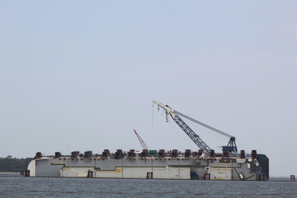

Sep 22 12:25For the first timesince the 'Golden Ray' capsized off the coast of Georgia, crew members and the owners were speaking publicly about the moments before the vessel listed and overturned. The public hearing, part of the investigation into why the vessel capsized, wraps up on Sep 22.
Capt. Jonathan Tennant, the pilot who steered the ship out of the port at 1 a.m. on Sept. 8, 2019, recalled calm winds and good visibility. He said typically there were warning signs when something is wrong - alarms, the sound of crew members speaking rapidly in a native language, the engine room calling up. But none of that happened.
"Everything was just as normal as it could be, until it capsized," Tennant said.
Tennant told investigators the ship started leaning in a turn and started to over-rotate to starboard. He applied what's known as counter-rudder to reduce the rate of the turn, but it wasn't enough. He said the accident happened within seconds.
"When I felt like I was losing control of the vessel, I reached behind me where I propped up the ship's radio and said to Jamie on the inbound, 'watch out, Jamie. I'm losing her,' in which time she capsized, I dropped the radio, held onto the gyro, the ship capsized, I tried to ease the rudder, still trying to drive the ship."
Tennant said he had no context that the ship's rudder and propeller were already out of the water.
"I was still like an airline pilot trying to drive the plane, trying to solve the problem until it flew into the ground," he said.
The last person aboard, Junyong Kim, was rescued about about 36 hours after the accident.
He gave a written testimony for the hearing. Kim, the first engineer on the ship, also said nothing seemed out of the ordinary until the ship turned sideways.
Kim said that he was in the engine room, trying to protect himself and the second engineer.
"I grabbed him not to fall down to the end of the engine room because the engine room was ... a bit long. And if he falls down to end, he could be injured. So, I try to grab him to not fall down to the end of this."
Kim said the generator went out, the engine shut down, and the standby generator also went out.
He described water rising, and the room becoming incredibly hot. Capt. John Reed of the US Coast Guard testified separately that the inside reached more than 150 degrees, with passageways becoming a "death trap."
Kim said he and others eventually went into the water that had risen in the engine room to stay cool.
Smoke was visible throughout the rescue mission, indicating fires on board. Rescuers had to bore through fireproof glass and navigate passageways that had become vertical drops to rescue the people in the engine room.
"I keep thinking, why it happens to me. I think, if I have water, I could survive two days more," Kim said in his statement.
